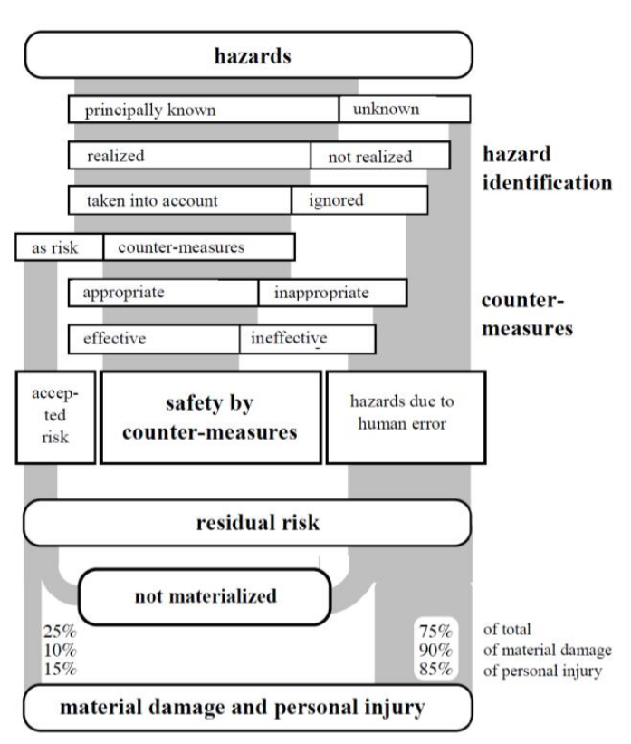

    Some 'complications' need to be accepted, though:
    1. The reactivation of risks associated with failing mitigation (on the failure tree side) -- this should be taken care of by monitoring mitigation effectiveness -- but also emerging 'secondary risks through mitigating actions as 'by-product' of good intentions, so to speak.
    2. The downstream risks in the event tree, which concern problems in dealing with consequences, from the simple case of failing rescue provisions (the fire brigade not making it through the traffic...) to incomplete investigations of the aftermath. For instance, a lesson learnt from the fire in the chemical plant in Basle/Switzerland in 1986 was to construct catchment basins for polluted extinguishing water [https://en.wikipedia.org/wiki/Sandoz_chemical_spill].
    Here is a 'risk breakdown' graph by Jörg Schneider (ETH Zurich) on drains to effective risk management (with typical percentages in civil engineering):
    Kind regards, Martin

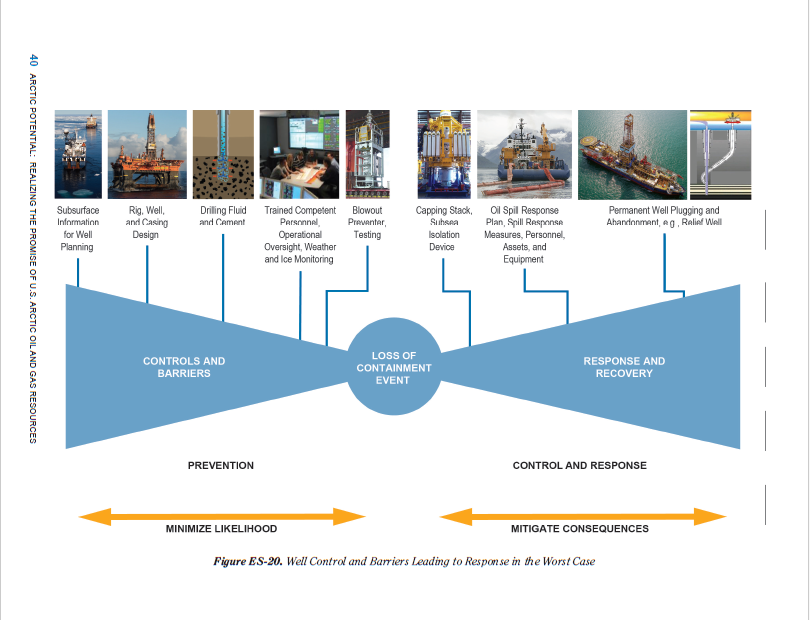

    Martin, your description of reactivation risks beings to mind the right-hand side of the bow tie diagram. In the bow tie depiction, the left-hand side is controls and barriers to prevent an event while the right-hand side is response and recovery actions to respond to an event.

  • 10.  RE: New Risk Definition
    Posted 12 days ago
    Thanks, David. Here's an example bow from the 2015 National Petroleum Council study, ARCTIC POTENTIAL - Realizing the Promise of U.S. Arctic Oil and Gas Resources. This figure was developed to help non-expert readers understand the measures used to mitigate the risk of an offshore oil spill.image

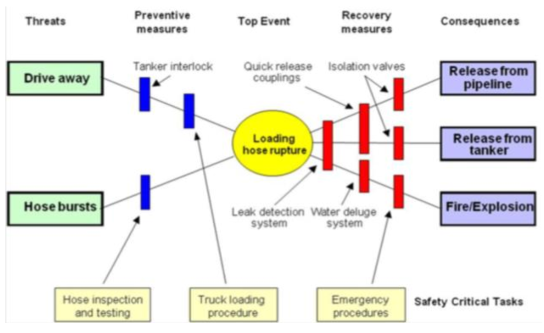

    Hi Mitch:
    Regarding oil spills I once found an instructive bow-tie application to accidents in fueling of an aircraft:
    I always liked the HACCP method of identifing critical control points (CCP) in hazard analysys (HA), which in this figure are  called "safety critical tasks". Perhaps we could exchange more such educational examples in our group?

  • 13.  RE: New Risk Definition
    Posted 12 days ago
    Yeah, what the military calls collateral damage...
    A fire brigade or ambulance on duty, causing a traffic accident, would be of that type, jeopardizing the relief action they set out for (risks of failing mitigation on the side of the consequence tree).
