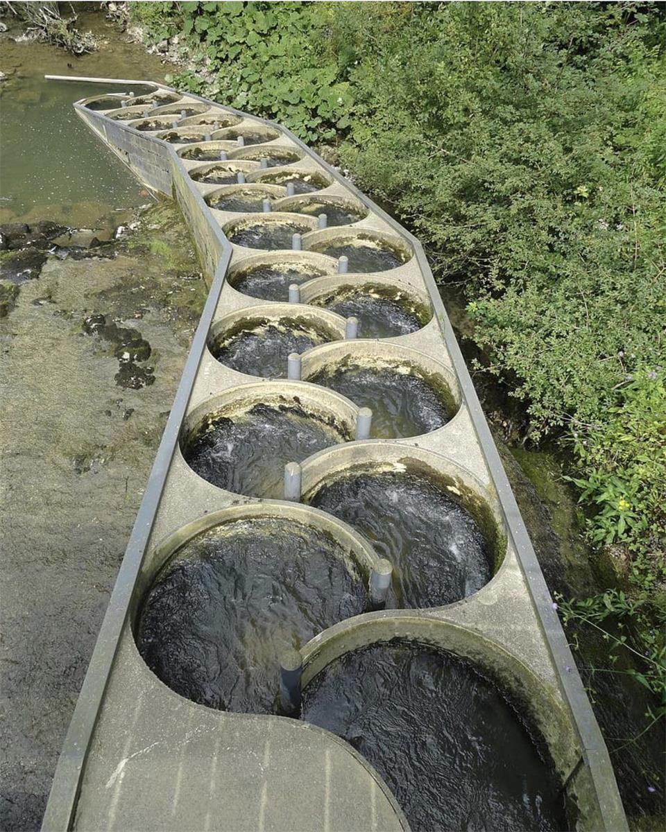

    Hello,
    I hope you are doing well.
    I'm currently tasked with designing a meander fishway type c, which is a type of fishway/"fish ladder" used in some european contries like Germany. I've read a few technical papers written in english, but so far I have not found clear, precise instructions/criteria for designing the system. These are the technical papers I've read:
    Hydraulic design criteria of the modified meander C-type fishway using the combined experimental and CFD models
    The meander-type fish pass: An alternative to the conventional vertical slot pas
    So far, the latter one does have some design parameters, but I find it hard to understand the following sentence: "The coefficient Δh(m) is the overflow head between the mean water levels of two adjacent basins".
    Have anyone had any experience working and designing this type of fishway/"fashladder"? What resolurce for the design parameters did you use?
    Example of the fishway meander type C:

    Hector – I do not have any experience on fishway engineering works – maybe some other colleagues would come up with a better answer.
    But, your question prompted me to look into it. I was able to download the 2nd reference you cited. You are right the sentence you quoted is not very clear – although Figure 9 of the paper gives a little clue.
    The best way to get an appropriate clarification would be to contact the authors. The first author's correspondence email address is there in the paper.
    There are some other sources I can cite – not dealing with meander type per se – but insightful nonetheless on fishway hydraulics. If not consulted already – have a look.
    IFM – Fish Pass Manual from UK
    NOAA Salmonid Passage Design Manual

    Hello,
    These designs sound a little similar to where we did multiple surveys at
    the Inn River in Germany (close to Ering), which was implemented by the
    Austrian hydropower operator VERBUND AG. There are a bunch of
    publications on these meander designs, but all in German; I attached
    them anyway.
    Here goes a summary of what's in it: The original concept of the meander
    fishway at Ering am Inn was a steep drop structure along the lateral Inn
    dam, so that the slope would be sufficient to convey sufficient
    discharge for bedload transport. This approach is now being implemented
    at another hydropower plant (Egglfing, also by Austrian VERBUND) where a
    meander fishway is not feasible because of a small natural tributary
    that runs in parallel. In Ering, VERBUND proposed using excavation
    material from a dredged island in the main channel to construct the
    meander fishway, to "dynamize" sediment transport by acting on the
    gradient rather than on discharge. But this was prevented by aquatic and
    terrestrial ecologists who argued that the system would "naturally"
    self-adjust without mechanically dredged sediment from the island. So
    mechanical intervention was rejected in favor of "natural development",
    including riparian forest and bank evolution. Now, in practice, dredging
    is required every year during fine-sediment flushing operations aimed at
    removing fines (clogs the surface layer). What is happening now is that,
    each year, material from a downstream sediment trap is hauled upstream,
    with volumes adjusted as needed.
    In addition, dense riparian vegetation largely inhibits lateral channel
    dynamics, and the upper reach of the Ering meander fishway is strongly
    armored. Bedload placed upstream tends to just travel over the armored
    surface (without exchange), with dynamic gravel bars forming primarily
    in the lower reach. So this underutilizes the potential of the meander
    fishway.
    A supposedly more effective approach is to designate recurring reworking
    zones along the entire channel at discrete gravel-bar sites, including
    periodic removal of woody vegetation, to maintain gravel-bar and
    shallow-water functions. The objective of that is to preserve functional
    spawning habitat and suitable shallow-water areas for juvenile fish,
    acknowledging that, as in natural rivers, these features will not always
    form exactly where planned. A related EU Interreg project at the
    Technical University of Munich (Prof. Jürgen Geist) entitled "Innsieme -
    Spawning Habitat Management" covers tributaries, the Inn, and bypass
    channels, including dynamic and static bypass systems.
    So key design criteria included channel slope and morphology to
    reproduce conditions comparable to the alluvial plain of the
    hypothetically natural Inn, based on the attached publications and
    available historical imagery (kudos also to the US Air Force in the
    mid-20th century). In addition to gravel bars, slackwaters and small
    backwaters were integrated, which now require periodic excavation to
    provide juvenile habitat as larvae are transported here after hatching.
    Bed material was not specifically designed; it was local Inn gravel to
    indirectly account for original slope relations.
    Another criterion was the spatial footprint and constraint. Channel
    width was constrained to VERBUND-owned land, and needed to also
    accommodate a service road and a dyke. At the end of the Ering fishway,
    once natural ground was reached, more space was available on VERBUND
    land, but impacts on the alluvial forest were minimized there. For
    instance, trees with potential bat habitat were considered. Banks were
    intentionally not armored here to allow lateral erosion. Today, the
    fishway reworked the deposits effectively, but bank armoring was
    installed because of safety requirements.
    More details are available on the "BDEW" interactive map under (we
    worked at "Ering"), which presents three gradient-based concepts: (1)
    ramp with bypass channel, (2) floodplain reconnection with dynamic flow
    allocation, and (3) the island concept with gravel and shallow-water
    features (see also population model by Wolter, which found an increase
    in fish population). But the Wolter study also found that access from
    the fishway to the main Inn was not available for juvenile fish.
    I hope that helps!
