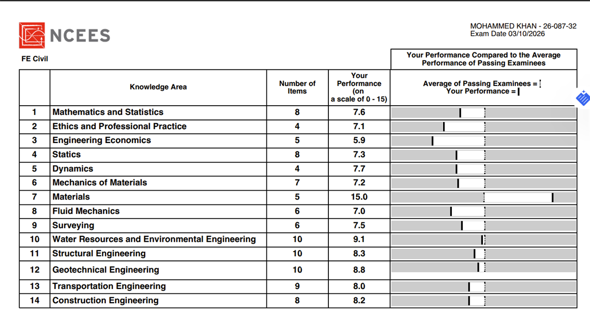

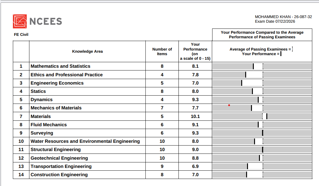

    Dear ASCE Community,
    I took the FE Civil Exam twice-my first attempt on March 3, 2026, followed by a retake on July 22, 2026.
    Unfortunately, my diagnostic scores have remained almost unchanged, and I am unsure how to adjust my preparation strategy for the next attempt.
    So far, I have:
    • Practiced consistently and solved hundreds of problems
    • Used PrepFE, Islam 800, Iqbal, and School of PE materials
    • Watched Mark Mattson's FE Civil videos
    • Tutored first-time FE candidates for nearly a month
    Despite the time and effort, I am struggling to identify what is holding me back.
    I would sincerely appreciate advice from anyone who has faced a similar situation:
    How did you improve after multiple attempts? Should I focus more on concepts, timed practice, the FE Reference Handbook, or exam-taking strategy?
    I am sharing my diagnostic reports for context. Any honest feedback or study recommendations would be greatly appreciated.
    Thank you!
    It is my first attempt of FE Civil
    It is my second attempt of FE Civil exam
    in the FE Reference Handbook.

    First, you did do better the second time.  There are 3 categories where you did as well as those passing the test, vs only one the first time you took the test.
