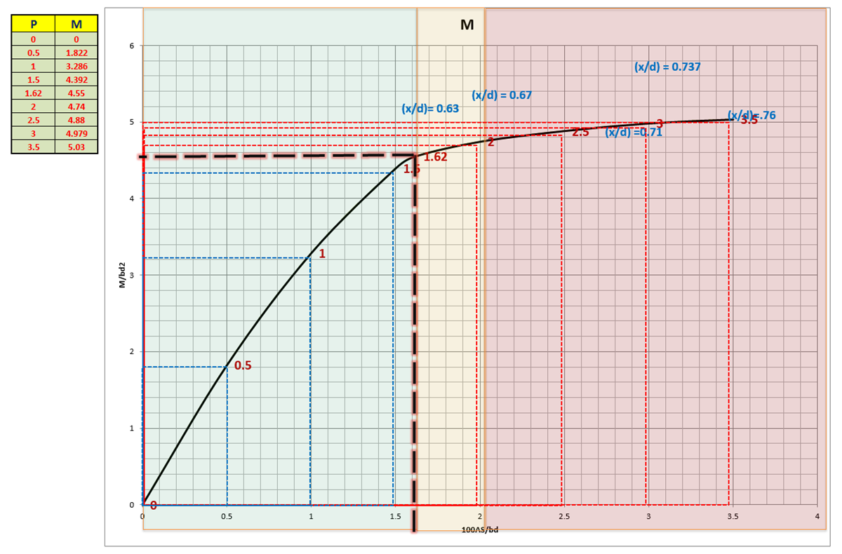

    2. First Principles Approach
    The initial curve was developed using a First Principles Approach during structural engineering coursework at the University of Khartoum. The following material properties were used:
    • Concrete cube strength: ( fcu = 25  MPa )
    • Steel yield strength: ( fy = 460  MPa )
    • Ultimate concrete strain: ( εcu = 0.0035 )
    • Steel modulus: ( Es = 200,000 MPa )
    Moment capacity was computed for reinforcement ratios between 0.5% and 3.5%. The balanced reinforcement ratio was found to be:
    [ ρb ≈ 1.62% ]
    The manually plotted curve was later digitized for comparison.
    Figure 1: First Principles Flexural Capacity Curve
    This Figure shows the manually derived flexural capacity curve obtained from the First Principles Approach.

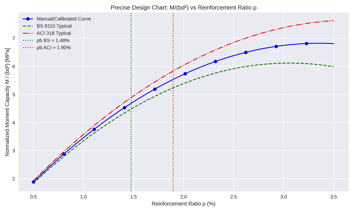

    Figure 3: Unified Comparative Flexural Design Chart (Nominal vs Design)
    figure presents the unified comparative flexural design chart combining the First Principles curve with the calibrated BS 8110 and ACI 318 curves.
    This figure presents the unified comparative flexural design chart combining the First Principles curve with the calibrated BS 8110 and ACI 318 curves.
    As clarified earlier, the divergence between nominal and design charts underscores the importance of applying strength reduction factors when comparing codes.

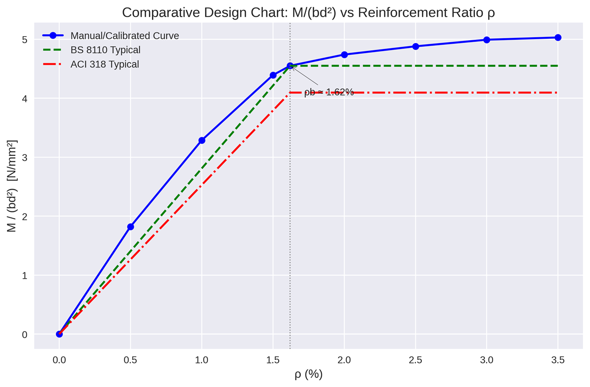

    Figure 4: Enhanced Unified Flexural Design Chart: Comparative Moment Capacity vs Reinforcement Ratio
    This chart integrates First Principles derivation with BS 8110 and ACI 318 calibrated curves. Legends include balanced reinforcement ratios (ρb) for each, ensuring clarity in comparative analysis
    This chart integrates First Principles derivation with BS 8110 and ACI 318 calibrated curves. Legends include balanced reinforcement ratios (ρb) for each, ensuring clarity in comparative analysis.
    Earlier charts, such as the Precise Design Chart Fig3, were based on nominal moment capacities and did not apply the strength reduction factor (ϕ = 0.9) to ACI 318. This caused the ACI curve to appear higher than BS 8110. The unified chart presented here reflects design moment capacities after applying all reductions, revealing the expected behavior: BS 8110 consistently yields higher usable design moments than ACI 318. Including both nominal and design charts highlights the importance of distinguishing between theoretical and usable strength in peer‑review contexts.
    Key Insights from the Chart
    • Balanced reinforcement ratios:
      • BS 8110 → ρb ≈ 1.48%
      • ACI 318 → ρb ≈ 1.9%
    • Curve behavior:
      • BS curve lies above ACI, reflecting higher design moment capacity for the same reinforcement ratio.
      • Manual/calibrated curve provides a smooth midpoint reference.
    • Practical takeaway:
      • Under-reinforced sections (ρ < ρb) are ductile and efficient.
      • Over-reinforced sections (ρ > ρb) plateau in strength and lose ductility.
    Key Observations
    • The First Principles curve aligns closely with BS 8110 in the under‑reinforced region.
    • ACI 318 consistently yields lower design moments despite having a higher theoretical ( ρb ).
    • The divergence between BS and ACI increases beyond the balanced point.
    Why ACI Produces Lower Design Moments ?
    1. Strength Reduction Factor (ϕ = 0.9) - ACI applies a global reduction to nominal strength, reducing usable capacity by 10%.
    2. Whitney Stress Block Geometry - ACI's compression block is shallower than the BS 8110 rectangular block, reducing both compression force and lever arm.
    This demonstrates that a higher ( ρb ) does not necessarily translate into higher usable design strength once safety and ductility provisions are applied.
    Peer‑Review Diagnostic Use
    A reviewer can plot the software‑generated design point ( ρb ), ( M/(bd2) )) on this chart. If it falls significantly below the ACI 318 curve for a design claiming ACI compliance, this may indicate an overly optimistic assumption or modeling error requiring deeper investigation
