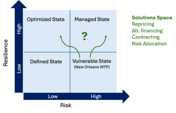

    Risk and Resiliency Classification: A key challenge, given the multitude of metrics is how to classify infrastructure risk and resilience.  As the risk of simplification, I have taken a page out of the business playbook (see 2x2 diagram).  Infrastructure assets (and their supply networks) should be evaluated for risk and resilience because low risk does not mean high resilience and vice versa.  A low-risk asset can also be low-resilience (rare event, catastrophic consequences), while a high-risk asset can be very resilient (frequent shocks, minimal downtime).  Hence, we need both frameworks to assess the long term value and function of infrastructure assets.
    An example of the former is a municipal water treatment plant located in a region with historically mild weather and low hazard exposure but with no backup power supply. It is low risk, because the facility sits far from floodplains, fault lines, and wildfire-prone areas.  Historical weather patterns show limited extremes (few storms, moderate temperatures) and hazard probability (flood, drought, heat, storm) is statistically low.  Hence, traditional risk assessments would therefore rate the plant as unlikely to experience damage.  However, it is low resilience because the plant has no redundant power source (no generator, no microgrid, no islanding capability), and a single substation outage or regional blackout would completely halt treatment operations.  Even a short loss of power disrupts water supply to hospitals, businesses, and residents, while at the same time recovery could take 24–72 hours, depending on utility repair schedules. Minimal operational flexibility or backup capacity render the asset low resiliency.

    Opportunity for CIRM: Since risk and resilience are two sides of the same coin in assessing infrastructure design and functionality, we have an opportunity to develop asset/sector/geography/shock-specific risk-resilience quadrants to profile the nation's infrastructure assets using the metrics from the table.  Different assets are individual infrastructure projects, while sector refers to e.g. energy to water utilities.  Shock is based on what committees have told us, and may refer to financial, cyber, or climate.  These 2x2s and metrics table could be sent out to the various infrastructure committees/agencies for input after we develop a few examples to start populating a database with risk-resilience profiles.
    A further CIRM opportunity pertains to exploring the relationship between infrastructure resilience ('Can the system continue to provide essential services during and after a disruption?') and risk mitigation ('How do we lower the probability or consequence of a specific risk?').  While these concepts serve different roles in managing uncertainty, protecting assets, and ensuring long-term system performance, one of CIRMs subcommittees is focused on 'Infrastructure Finance Risk' with emphasis on resilient infrastructure financing, risk allocation, contracting and design.  The subcommittee seeks to encourage and advance approaches to assess how financial, operational, climate, and regulatory risks affect infrastructure assets and capital planning.
    In the context of the risk-resilience 2x2 diagram, the implications are whether and how current infrastructure assets in the lower two quadrants could be 'hardened' and rendered less vulnerable to hazards, towards an optimized or managed state of higher resilience at its current or a lower risk profile.  The solutions space for these assets thus leverages risk-pricing and revaluing, attracting alternative financing options and explore more right-weighted risk allocation strategies.  Risk mitigation should be thought of as an input.  Resilience is the desired outcome.

    This is an excellent discussion, Peter. Resilience is indeed one of the several desired outputs of risk management, along with other objectives, including safety, effectiveness, and economy. In those cases the vertical axis of the 2X2 can be any objective.
