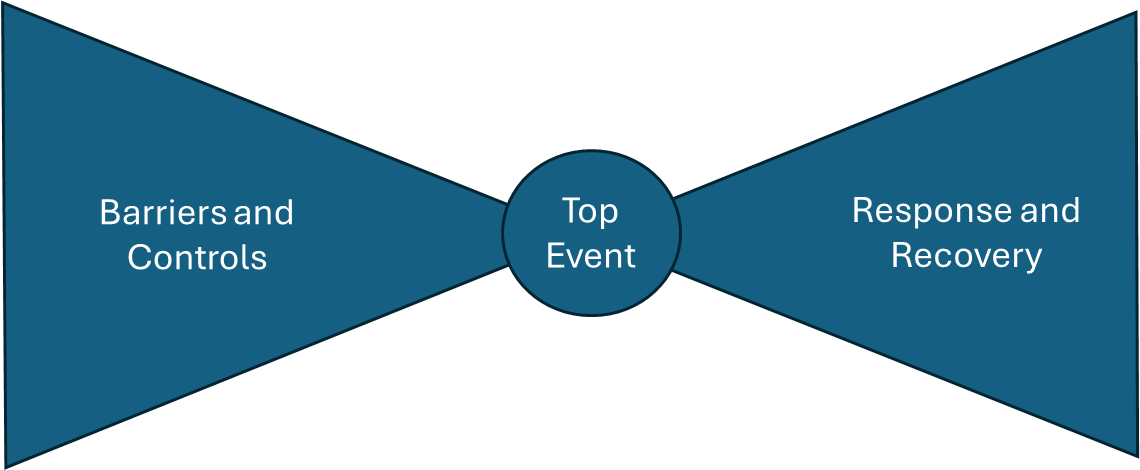

    Have others come across the use of Bow Tie diagrams as a means of managing risk, and what were the circumstances? They can be as complex as you want. In their simplest form, they depict the mitigations, referred to as barriers and controls, to prevent something bad from happening on the left, and the options for response and recovery on the right. The bad thing could be a loss of control or failure, and is referred to as the top event.
    The flooding disaster along the Guadalupe River in the Texas Hill Country prompted me to think about these diagrams. They provide an insightful framework for piecing together all that happened and for thinking about the future. Besides providing a framework for managing risks, they can be invaluable for communicating risk to others, based on my experience.

    As I reflect on civil engineering, I have come to realize that the discipline is fundamentally all about risk management. Almost everything we do as civil engineers has a probability of failure. For many aspects of civil engineering, this risk is addressed via codes, standards, and guidelines,  referred to as the Standards-Based Approach (SBA). The safety factors and load and resistance factors that we use have been calibrated from analysis or anecdotal experience to yield societally acceptable levels of failure. Perhaps this historic reliance on the SBA has contributed to risk management becoming a secondary activity rather than the primary work.
