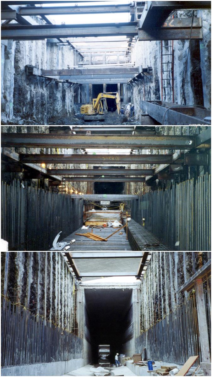

    I would help illustrate to the younger engineering students the importance of Statics fundamentals such as free body diagrams, sum of all the forces equal to zero, reactions and fixed ends, etc. are the building blocks to complex underground shoring systems, sizing of beams, struts, and walers, and permanent underground infrastructure.  It's series of free body diagrams rotated 90 degrees.
