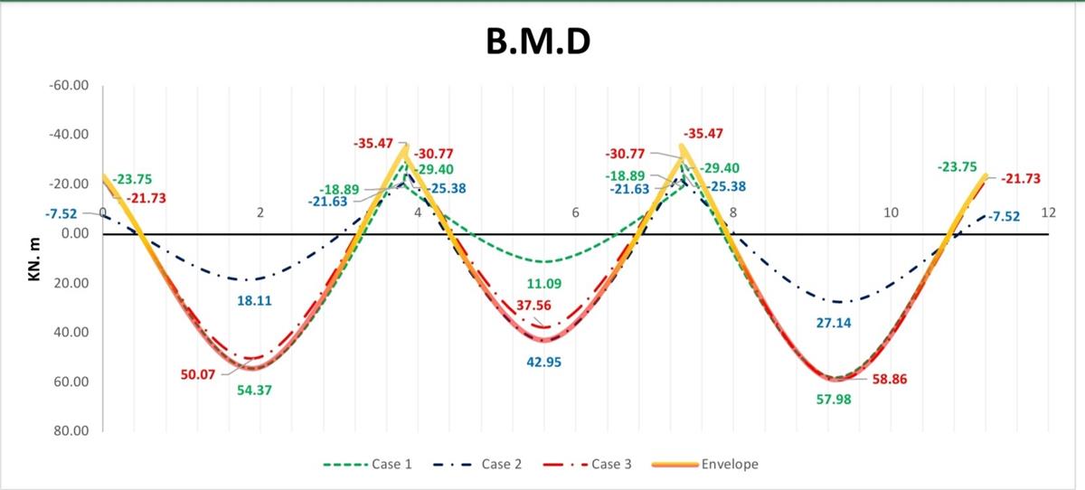

Building on the excellent points raised about uncertainty and communication, I'd like to share a practical experience from a structural analysis course I taught, where students explored multiple approaches to solving the same problem.
One case involved applying the moment distribution method in Excel. A conventional, conservative use of this method often yields a safe result, but it can obscure subtle shifts in structural behavior. By deliberately increasing the internal precision (e.g., retaining more decimal places through iterative cycles), we uncovered outcomes that were not only more accurate; but also revealed opportunities for more efficient design results, comparable to those produced by advanced analysis software.
This level of precision is not a computational artifact; it's a gateway to the model's full predictive power. The key takeaway, which echoes your insights, is that we must be masters of our tools. We need to discern when internal precision is essential for rigorous analysis, and just as importantly, when and how to round results for effective communication with clients, who often care more about scale than decimal detail.
